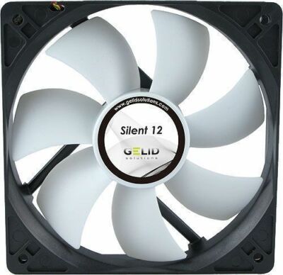

Apparently everything out there is designed for VW factory windows only, so I made something similar with 4mm ply and bits and bobs off of eBay.
The top and bottom slides secure it in the glass channel, held tight by wing nuts. When camping I leave it in place all the time.
I bought this fan as I wanted to leave it on overnight although it’s on 24/7 at the moment.
There are various speeds available, the higher the speed the greater the volume (dB and cfm!).
Runs on a 12v plug, though USB versions available.
Combined with a small fan heater it does enough to avoid condensation.
