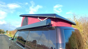

Like this one we did?
This is my set up...which you in turn attach the awning to the Thule wind out awning flap with the 'figure of eight' Kador strip. You can also wind out the Thule awning and then attach your air awning to that.
Have a read of this thread and the associated links off it. Fiamma do a variety of brackets to suit.
what pop top have you got installed? The SCA covers the multi rail channels so you can’t reuse them. If you can still see the channels then these can be used to secure the bracket along with your existing drive away awning rail.
