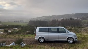

Set getting fitted tomorrow of the Unknown. I was going to go for the Gp7 as well but decided to give the new ones a try. Silver on silver.
