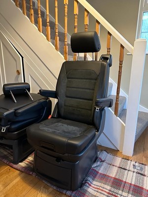

I’ve just bought a great T6 Caravelle, but only one of the second (middle) row seats has the swivel base. Would anyone care to swap a swivel seat for my non swivel seat?
In Surrey would be ideal, but will travel if needed.
This is the seat cover style in image.
Thanks.

There are indeed two types of Velle seat. Those that swivel and those that don't. On some of the Exec models they came as a 2 / 2/ 2 and the rear 2 didn't swivel.
Have a good look at both seats and compare to see if something is missing or broken. Add some photos from the front and the rear.

I’ve checked and they are different seats, their tilt handles are in different places. Just looking now on eBay for a swivel one. Wondering if I could find someone to part ex so I’m not left with a non swivel I don’t need.

Yeah it's only the middle row captains chairs that swivel, if it was specced from new as having 2x captains chairs on the rear row, they don't swivel.
If it doesn't have the little lever in on the middle on the front of the seat it's not a swivel one.

After much research I can confirm that there are 2 types of captains chairs for the rear passenger seats in a caravelle. Those that rotate and those that don’t. And you can’t buy anything to get the ones that don’t rotate to rotate. Essentially the non rotating ones are usually fitted at the back row if you don’t want a bench. If you want your second row to rotate, you’ll be needing to look at eBay for used ones or VW for new ones. And then try and sell your non rotating ones.

If they're not the swivelling chairs then you can't 'make' them swivel. However, if they're facing rearwards then it sounds like they've been fitted the wrong way round?
The swivelling ones have a small handle at the front which allows them to swivel.

Obviously this isn't as good as swivelling, but if you want them facing either backwards or forwards, you can lift them out of the rails and turn them through 180°.
