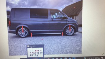

Hi there. If the eibach springs are lower than 40 mm. The special active can’t work well. , please measure the van for me , we won’t sell eibach so assume you had them fitted else where . ?. Send all the details so we can get that working properly. Becuase the special active is. Streets ahead in technology and by far the best shock you can buy. , just limited on drop as it needs travel when the special active valves kick in
