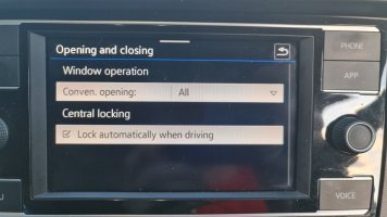

Hi All, looking for some help with the auto lock when moving function on Carista as I cannot get it to work. I have a 22 plate 6.1 Highline. I first tried the standard app, managed to get into the settings for auto locking but nothing happens when I set the options to yes. I then tried the Beta App and again it didn't work. The infotainment system has it ticked. I have tried all combinations of the three options. I have also reset the infortainment to factory as the app said this might work. I did manage to get the folding mirrors to work so I know that the adapter is able to save settings to the van. I also tried with the bonnet open and closed.

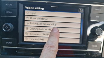

I have read on here that some people have option A and B, I only get one option for my van. I'd be grateful for any further suggestions as I am at a loss of where to go from here. Screenshots in case they help:
Normal door locking with the remote or diver's buttons work fine by the way.
