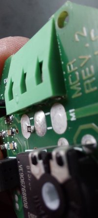

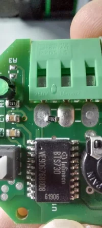

I decided to take the dimmer switch apart and after a good look about on the pcb I noticed that a 102 ohm smd resistor that sits between ground and 12v out wasn't soldered on one side!
I soldered the resistor onto the 12v out pin and after testing the switch in circuit it works like a dream and no dim lights when the switch is off.
