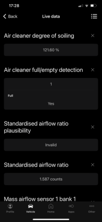

What's shown under: OBDeleven > Control units > Engine > Live data > Air cleaner degree of soiling

No errors in obd11
Degree of soiling 122% (whatever that means, not sure how it detects that, I cannot change it).
Currently running a ram-air foam pannel filter, have been for quite a few months.
