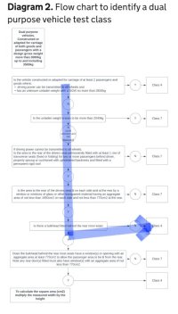

There’s a pretty comprehensive definition of a dual purpose vehicle in the Type Approval Regs. Does your van meet the requirements?

That's what I'm getting from the .gov site. Most garages are just over cautious
Whilst that flow chart is relevant, the words above it on the website are important too;
My T6 has an unladen weight of more than 2,040Kg, (because it's a 4Motion), so can't be a dual purpose vehicle for test purposes.
