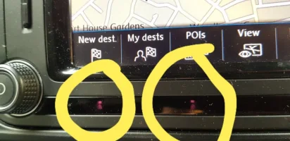

You can use your phones camera to see if the infra red leds are working..
The radio uses the invisible reflection to detect your hand...
It's easier to see at night..... but here's a shielded day shot....
