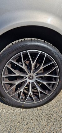

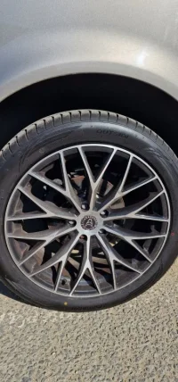

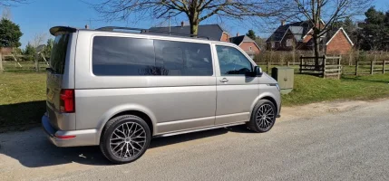

I've just got my new (to me) 21 plate T30, and I want to make sure I can get into carparks etc so looking to get it under the 2 meter mark, I know this has been discussed multiple times, but I can't believe I'm measuring it right. It's on 20 inch alloys with 275/40/r20 tyres, and has roof rails. I'm told it hasn't been lowered and I can't see that it has, the springs don't look like it atleast. It also has rear spoiler.
I'm measuring it at just 2010-2020mm unloaded, which seems low considering the 20ich alloys and roof, do you think I'm not reading it correctly, does that sound right? If I am I'd just have to take the rails off and I'd be under. I'd like to keep the rails as it looks nice, but until I get it lowered that might be all I can do. I will also be occasionally going out loaded with with a 480kg-ish payload so wouldn't ant to get it lowered by much.

The best way to measure the height as it is now is to park it on level ground, lay a straight edge/timber batten across the roof bars so that it overhangs the side of the van, then measure from the batten to the ground.

I've messaged 445mm on front and 450 on back, baring in mind the 20inch alloys
Assuming your 20 inch wheels have the same/similar circumference as the original wheels (if they don’t this would affect the speedo readings) then your van has been lowered albeit only about 10mm from the standard 460 mm so yeah it’s going to be tight going under a 2.2m car park barrier

If you’ve measured centre of wheel to arch at around 450mm it hasn’t been lowered regardless of what wheels you have that measurement only ever changes if lowered.

VW T6 brochures list heights as 1990mm.
Wheel-size.com lists radius of 275/40r20s as 19mm more than standard 215/60r17s.
Then taking your measured wheel centres to top of wheel arches from those posted by @dubber36 and your maths seems good?
