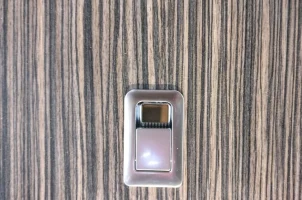

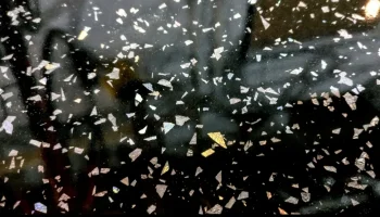

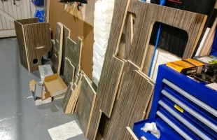

This is beautiful!
Is your worktop & table glittery? It's high up in my priorties list... but doesn't exist on Vinny's!!!
Great advice. Cheers!!!!
Yep a self build kit from EVO.
Great quality, even matching wood grain through all drawers & cupboards etc.
