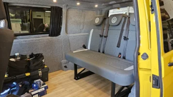

Here's a pic of the van in Germany.

Hi @middle-englander The kitchen design is an adaptation of an Evo-motion one, although I made it. Buying it from Evo would have been much easier but they are quite pricey and the lead times were very long. I did buy the handles/catches from Evo. I bought the oak worktop on eBay from a firm that makes oak stair parts. The bed is a 112cm Rib Altair in Simora fabric to match the front seats. Cheers.
