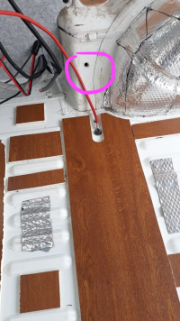

How would you get a ground point in the van for a big 50mm2 lug? My install is going in a kitchen cupboard around the front area of the rear O/S wheel arch. I found what seems to be a threaded hole on the front of the wheel arch - maybe previously a lashing point. Could that be a good point? Scrape off some paint and use a toothed washer?

From someone else's photo, the circled point is what I was thinking for the ground
