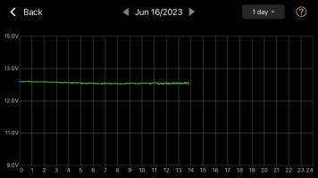

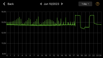

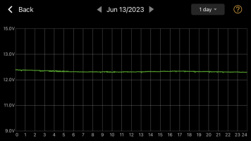

First revelation was that despite having an EHU point at the back of the van - there was in fact no LB charger onboard. So it served only to provide power to the 240v sockets when in hook up. The only way of charging the LB was via the Sterling B2B system (BB1230). So I suspect the LB had been left to run low and may have been affected. I’ve continued to plod on with that existing LB and a Halfords smart charger but it does seem (via the BT2 BMS devices recommended here) to drain to low levels over a period of 4-5 days. So I’m trying to work out if there is a parasitic drain and what might be causing it OR whether in fact the LB is knackered. Or both…

Battery monitor screen grabs below - to show last Saturdays journey from a fully charged LB, then left unplugged since then, with a couple of short trips. (Thinking the fridge might be draining the LB as there is no isolation switch, this week for the first time I’ve removed the 10a fuse. ). Too early to tell but I do think the charge fall off might be better than it was previously.

having a look at the BM2 plots above. . . .
at no point does the battery voltage drop below 12v. . . .
you can see the charging from EHU and engine . . ?

Thanks @Dellmassive - I’ll turn the fridge on and see if I can capture it trying to come on on the BM2 and whether that pulls it below 12. So generally - those plots with the slow discharge over a couple of days, do they look normal to you? I have no idea.

To check if you have a drain... You need to meter out the power at the battery.
A 2week bm2 plot may show enough data to get a rough idea....
But the battery test will defo tell you.
