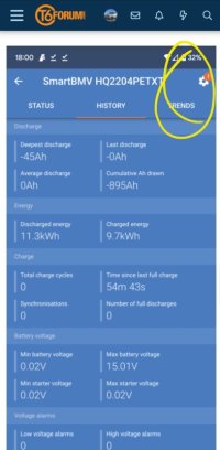

Some screenshots of the roamer app as well .

Looks like you're Victron needs needs a fw update.

Screenshot_20230213_073318_Chrome.jpgScreenshot_20230213_073344_Chrome.jpgScreenshot_20230213_073412_Chrome.jpg

Yes, need to update the Victron app
