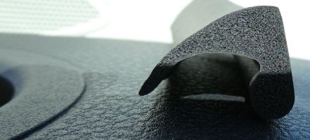

I too wanted to close that gap between windscreen and dash and looked around in Australia (particularly in Perth, Western Australia) for a similar profile but could not find it. However, at our local Clark Rubber (2km away) found this L Section EPDM Sponge Door seal and it fits very well (I would suggest even perfectly). L Section Sponge Door Seal 24.5mm x 15.5mm
I eased the "knobbly" bit into the gap and the flat part then moulded very nicely with the dash. Be careful not to push too far down into the gap but easy enough to pull up and try again (says the voice of experience :))

I think 1.6m would do. I bought 1.7m length - just in case :) but did not need it all. Don't be too aggressive pushing it down into the gap until you have a look from the outside.
