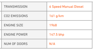

In the end I did a RAC online check, and that seems to conflicts on some of my earlier thoughts too.. I read that 75Kw was a for 102bhp, but RAC say 140, it also says it’s 6 gears., yet it found elsewhere it was 5. It does however tell me it’s EURO 6 - which is good and I checked the reg on the ULEZ site to and that confirms it too.
Still strange I can’t find out for sure..
102 bhp can be euro 5 and 6 and only 5 gears
140 bhp is the old euro 5 and only available in 6 gears
150bhp is the euro 6 and is 6 gears also
75kW=100.577 HP
If it's a 2018 then odds are it has adblue and euro6. 5 gears means it's the lower engine either 102hp or 110hp. 6 speed and DSG will be 150hp or 204hp. Euro 5 was on the earlier run models upto 66 plate.
If the RAC simply did a VRN look-up, then their report will be wholly reliant on the V5 being correct - not a data source that's 100% reliable. The most reliable source of info will be from the VW factory - i.e. the build sheet.
