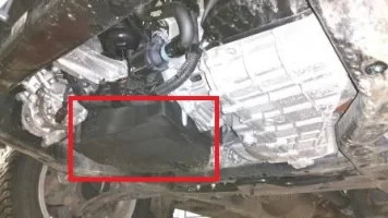

does anyone have the part numbers for the oil pan insulation?
This possibly ?
Its worth noting that vehicles with this part fitted have a different sump, states with opening for oil level sensor
The engine (with insulation) in the picture above is of type CXFA (110kW/150PS, EU6).
