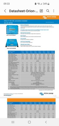

I have a victron 12-12 18A charger currently so can change the profile easily enough.
Do you think the victron dc-dc convertor would work?
possibly . . .
