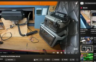

take a look at this guy . .
he shows an Autoterm running on a powerbank fine . . . but you need to use the 240v side and a 15A or above PSU ( ie victron ip65 15A>)
but shows the problems when trying to run from the EF 12v port.

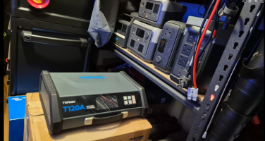

piuc,
TopDon make some good - and they have been around a while now. . .
this is my latest toy. . . 120A charger
Mwah..hahahahaha :cool:
