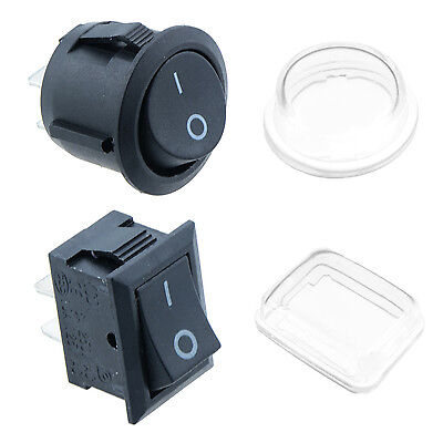

It is very simple, I just cut in to one of the wires a few cm back from the light unit and then ran a new wire to the switch.
I pilot drilled from the back of the blanking plate to get the centre point and then used a 20mm still bit from the front to do the main hole cut out and then the switch just snaps in to place. It is a simple little job.
Thanks mate, looks simple enough, those snap on switches are handy.
What are the red things you've used to join the cables?
Just standard hand crimp tool butt connectors. I used similar spade terminals on the back of the switch as well.
This is a great tip thanks. Just done the same on my T6 - only advice from the pic above is not to fix switch wire quite as close to light connector - just in case you screw up the butt connector and have to redo.
Great posts thanks , yes I did fit an led lamp, but still annoying not having a switch.
Can someone lead to to a link for the switch please?
