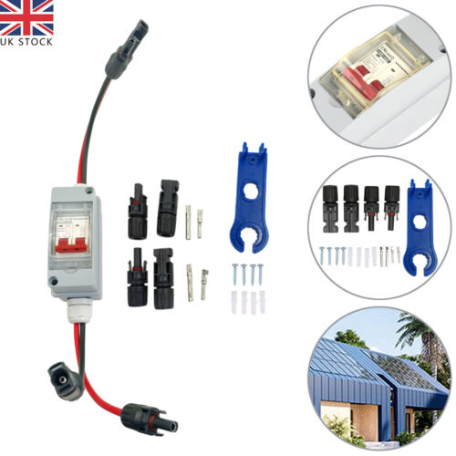

A solar panel is a source of power so ideally do not disconnect under load. Simple way of doing that is do it after sunset.

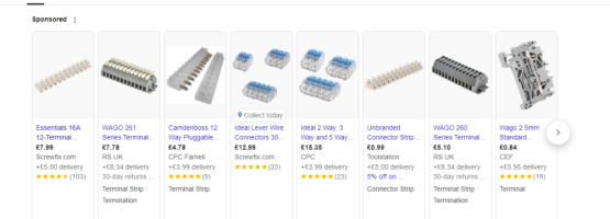

I'm assuming you don't have the standard MC4 type connectors from the pictures - it might be an idea to consider fitting a set for future maintenance - but so long as you take each wire out individually and make sure it's insulated before you move the other one the risk of any short is minimal. A simple method might be to temporarily attach something like standard insulation connector block to the bare ends - don't just rely on tape!

as above.
lable the wires first before you unplug anything.
take pictures on your phone.
remove the battery fuses that connect to the MPPT,
then unwire one core at a time, and put in terminal strip or wego
