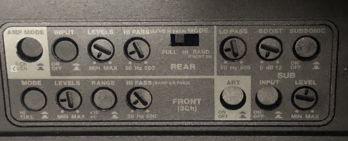

This morning I dropped in the van for the rear bumper to be sprayed but managed to snap some photos before it went in. I got photos of the head unit I'm using, the amp settings and the sub enclosure. I couldn't get the door speakers as I'm not too familiar with taking door trims off!
Does this all look in order?

Cant really see which buttons are up and down but......
You don't mention rear speakers so the amp should be running in 3 channel mode. 2 for front L/R and 1 for the sub.
The High pass filter to your front speakers is set to 500hz. meaning only frequencies above this will go to the front, there will be another crossover that will split this further and send 2.5k hz plus to your tweeters and anything below that to the door speakers.
Your sub Lo Pass filter is set in the middle so say around 225hz so the sub will get any frequency below 225hz. Already you can see that any frequencies between 225hz and 500hz are missing and are being filtered out.
Also IMO 225hz to the sub is far to high.
Set the Lo Pass to the sub to something around 80-100hz. The Hi Pass should be similar Then anything below 100hz goes to the sub, anything over goes to the front speakers.
What Deaky said. Set the lowpass to 100 and the highpass to 90 then have a play with the gains for the front and sub.
I'd be tempted to knock off the hi setting on the mode button on the front section of the amp and select full instead then your main speakers should get more range which should fix your vocal issue.
To set the amp gain turn it right down 1st, then up the volume on the headunit to 90%, then amp front gain up bit by bit until you start to hear distortion, then tweak it back a tad for safety and note this gain position. Then headunit to 75% then amp front gain up again bit by bit until distortion. Finally set this gain between the first noted position and this final position. Now go to work on the amp sub gain till you get the system volume balanced.
@NomadicCreatives. Your setup only has 4 wires from the amp to the speakers and 3 CH is selected on the amp so they've not wired your tweeters up separately but if you did wire them up this way then you'd have full control over the filters and gains the amp supplies to the tweeters, mains and sub. This is how I'd want mine wiring ideally especially if I'd spent that kind of money on equipment.
