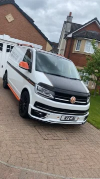

Yeah 250L tank which is pretty standard for our work .
They sure do, you think I should add some? What’s the best setup regarding size?
Fitting spacers on the rear only and yes I probably would as you've got a little bit of overhang going on there but only a modest 20mm of spacer at most.
If you want a beefier look then go staggered.
They're 8.5" wide 18s with 255 45 with 20mm spacers on the back and sitting on H&R coilovers, ride height is limited by underslung water tank... 70 litres! :whistle:
