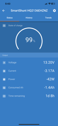

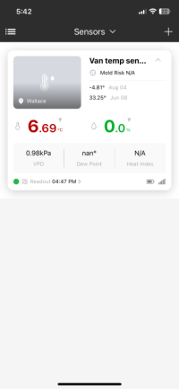

  • I have a temp monitor in there the fridge has been running for the last 4 hours - I have opened it 3 times to check and tweak the temp setting, temp is dropping but not significantly

If you're trying to check a fridge then give it something to work on, the thermal mass of thin air is very low and not what it's control logic will be expecting.
Pop a few bottles of water or cans of drink in and see how well it stabilises.
