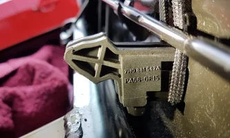

When I fitted my Vankraft reduced height base I had a little trouble with removing the clip from the old base and installing it into the new base. The end result is it now rattles, annoyingly. So I am hoping that by replacing that little clip thing it will be resolved. Can anyone tell me the part number please? It is a plastic body with two sort of springs inside.
This piece?
It probably is just a case of closing the wire so that it clips around the plastic bit.
I will try that first and I am not sure why I didn't think of this previously.
Doh.
Hard to be 100% sure but think its these parts
Spring is 7H0881243 and priced at a mighty £1.80 + vat
It is the parts numbered 5, 6 and 5.
I've got that in my seat. Will photo it when it gets home tonight.
Edit Although I see it in your photo too. I don't think you've got anything missing, looking at the parts diagram.
From looking at my photo - the metal spring where the join is appears slightly bent away so I am going to pull it back upwards to make the connection tighter - and hopefully job done.
