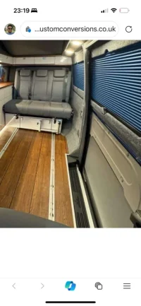

I think I’ll finish the floor on top of the step with some aluminium angle profile to cover the edge. Like Knights Conversions in this pic…
Yup - can’t remember why I didn’t do that in the end! I took this pic at a converters to help with planning… might be of use
Nice, I like that 45 degree angle better! Think I’ll do that. Luckily it’s the piece I’m cutting next.
