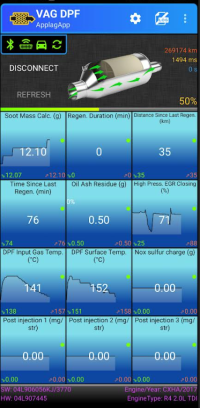

I would propose to monitor temperatures along the exhaust - preferably all 4 sensors - minimum DPF input temperature.
Ideally using VCDS, or something like -

Try the DPF monitor app, which is pretty simple to use, to better understand what's happening. They key is to see how many miles since last regen. You should be seeing 200 miles for motorway driving, less for urban. If a brand new DPF is clogging up quickly then the engine isn't running right. How is oil usage?

Thanks, I'll try to do this on my next run
It can go about 150-200 miles to reach 24g for regen, soot seems to collect around 0.1g every couple of minutes urban (very roughly) and slower on motorway.
