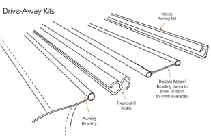

I expect so. The rail should have a channel in it that accepts the connection to the driveway awning (picture lifted from Dometic website)
I have a different brand of roll out sunshade, same concept, and when I get round to sewing the correct bead to my old awning I will have the same thing.

you can use any drive away awning you just need to have the right kador strip to fit your wind out awning example fiamma wind out has 4mm connection slot so a kador 4mm to 6mm and a 6mm figure of 8 that your awning slides into

@Steveofar, Hi, yes you can. The awning has the channel for using a generic awning driveway kit to attach it to the driveway awning. We've been using an Outdoor Revolution Cayman Combo with a Dometic PW1100 for a couple years now.
