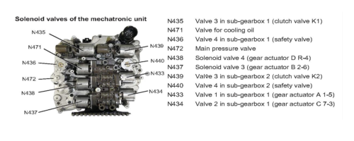

Given the particular error about gear selector 3 I’m guessing it’s maybe solenoid N434 that’s the knackered one, or am i barking up the wrong tree…

The mechanic got into the mechatronic unit to find parts not compatible. The silver lining was that he also noted the cover seal was some instant gasket crap and that had caused little beads floating around the unit. Thoroughly cleaned everything, boxed back up, fresh oil and filter and touch wood not a beat wrong since.
