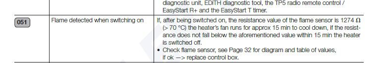

Eberspacher problem. Went to fire my heater up today and nothing? I believe it’s a D2 or 4. It had error appear the other day but today has come up with this code. I can’t find original documents. If anyone could please help it would be greatly appreciated.

the only 51 code that I can find is:
