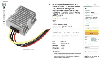

Right I took some more measurements today
Battery voltage 13.21V lights on
Voltage after LED fuse 13.20V lights on.
Heater switched on - battery voltage 13.12V
voltage supply to LEDs (after fuses) 13.11V
So I am thinking it cant be voltage drop that is causing the lights to flicker.
So would a voltage stabiliser like this help, would I need one that outputs 13.8V or 12V?
It seems odd to me, the draw from the glow pin is constant not pulsing ( gradually diminishing from around 10A down to 8A ) so if it isn't voltage drop before the led driver circuit it must be the led driver that is being affected somehow. Any pulse from the motor operation would be constant during heater operation so that can be ruled out.
I would look at the voltage being put out by the driver - this is where an analogue test meter is better than a digital multimeter - moving coil meters will show the voltage fluctuations not seen on a multimeter.
I had this exact same issue with my interior lights when running the diesel heater on my leisure battery.
I fitted the above 12v output version to the lighting circuit and all issues have gone away. I do isolate it when lights aren't in use. On occasion I haven't and I'm sure it's adds a slight load to the battery.
Strange how only us seem to have had this problem and no one else.

Thanks @PaulR83 I have 2 LED strips running on separate 5A fuses. DO you think 1 of these and then splitting the output to the 2 strips would work, or would I need 2 of the units.
Yes, strange how it us just us out of all the forum members, but I think its more common than we think.
Which heater - was it an Eberspacher as well? Just wondering if there is something common to them.

Interesting for sure. It was very subtle I recall but just annoying. Can't remember if it did it on hook up too.
Depending on load you may just want to common them up. I doubt the lights draw that much. Mine were all run on tiny cables which may not help.
I only did it for my main roof lights, I added it before my touch dimmer and all works. I didn't do it for my tailgate lights and they still do it, but rarely use them and if I did, I doubt the heater would be on.
I find it strange too the only 12v regulator is a Chinese ebay one.
Think the only other I found was Victron one too if you want to go full team blue! They are slight bigger and I don't think it would have fitted behind my B pillar trim.
