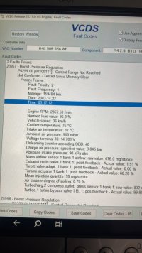

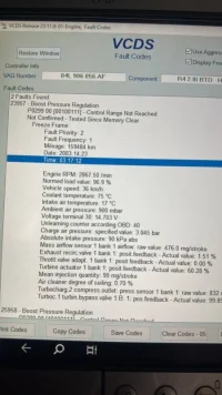

So the Van now drives but does not go! No Boost from Turbo.......been over the Vacuum maze a few times and looked for leaks in the intake side.
Any Suggestions....?
Engine Fault 23957 Boost pressure regulation
Engine Fault 25958 Boost pressure regulation
So today more VW hell..........the van idles just fine but no boost and no faults until you ask power out on the road.....then lots of black smoke and the above codes.

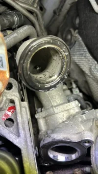

After much tube chasing and concluding that everything was installed correctly I found this post :
So it seems I have joined the failed turbo camp on a new (to me) engine just installed.....will ask transporter heaven were I got the engine from if they can refund some of the money I paid to go towards a new turbo......
does anyone know the difference between the turbos 03N145701M and 03N145703M as they seem to both be bounced about in relation to the CXEB /CXEC
To Close the story I got a reconditioned Turbo from Germany and swapped it out. the engine now runs fine but am still occasionally getting P226D Substrate missing (with a brand new DPF) and Black smoke on load. there is also a whine that sounds like a powersteering pump on full lock (suspect either the pump or the Alternator bearing).
