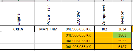

Thank you very much. Initially I was curious about engine software+4Motion combination. And actually you provided a confirmed piece into my puzzle. YouR engine software version is 3803 - which was a kind of expected.
So I'm fairly certain your engine code is CXHA (found on configuration sticker under dash in driver's footwell). Also I'm assuming there is a software update available (latest version 6187).
Anyways, about the faults. Carista has sometimes difficulties to associate faults correctly with control units. E.g. fault 00523 Intake air sensor actually definitely belongs to engine.
Also the fault code 16399 is very strange - no such fault can be found anywhere (=especially very reputable site Ross-Tech Forums doesn't recognize it).
Based on Carista's data the best guess for engine light is the fault 00523 - Intake air temperature sensor - which actually is integral part of air mass meter... (16399?) Any work done around engine air filter?
