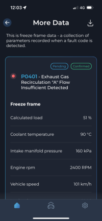

Drove the van into town earlier and on the way back the engine warning light came up on the dash in orange.
Once home, I plugged the Carista in and got the following fault code:
P0401 - Exhaust Gas Recirculation "A" Flow Insufficient Detected
Freeze frame :
Calculated load: 51 %
Coolant temperature: 90 °C
Intake manifold pressure: 160 kPa
Engine rpm: 2400 RPM
Vehicle speed: 101 km/h
Intake air temperature: 18 °C
Air mass value: 47.65 g/s
Absolute throttle position: 83 %
Time since engine start: 568 sec.
Fuel rail pressure: 114200 kPa
Ambient air pressure: 101 kPa
Battery voltage as seen by the engine ECU: 13.17 V
Relative throttle position: 69 %
Outside temperature: 18 °C
Absolute throttle position D: 44 %
Absolute throttle position E: 44 %
Commanded throttle actuator position: 100 %
I then reset the faults so the light went off on the dash, took the van out again and gave it a good blast up and down the A1 (75mph most of the time) van drove lovely, and no different than usual.
Is it something to be worried about/something I need to get seen to or can I just keep driving it normally in the hope it was a glitch and won’t show up again?
