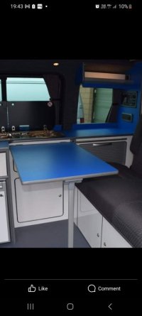

Here's a pic of a 112 on a twin side loader we did a while ago. If you look at the smev unit, I can't see how you can loose a extra 80mm for a 120mm bed.
You will struggle on a SWB due to the depth of the units and fridge, hob etc. Here is LWB twin door for example. For a SWB twin slider we have a ‘Panorama’ model which is similar to the 4th and 5th photo but will work on a twin door. Of course there are down sides with this, swivel drivers seat etc. Ther are always plus and minus with designs of vans. Cheers
