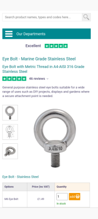

Before we decide if we need a roof rack or an awning etc. I am looking for a cheap solution to provide a fixing on the van which could easily be removed should we get one.
I want to put stainless eyebolts into the blanking nuts in the roof gutter, initially to connect a semi supported hanging rail for wetsuits, but I'm sure I'd find other uses for it.
I thought a glazing sucker would be OK as the main support for the drying rack but a bit more fiddly and have something else to store in the van, but with eyebolts connected to the roof I could potentially fix a tarp ridge line to a tree for shelter at other times...
Do you think this will cause a problem, thought I'd seal thread with ptfe and washer if need be?

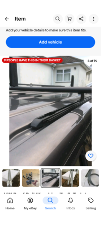

Or would a cargo rail be needed to help spread the weight/pull on the thread inserts on the van? The black rail on the image is out of stock and more than I'd like to spend really or does anyone know of similar tracks?

There is a good thread here around making roof mountings as waterproof as possible - as they are internal nuts you need to seal to both the roof and the thread:
I don't think they are really designed for the use you are thinking of as they expect loads to spread across all 4/5
For your use I'd mount a C rail in the roof gutter and then you can add all sorta of Kador strip accessories.
This is mine:
SWMBO open water swims and her wetsuit is quite heavy when wet - I think that amount of sideways load on an eye bolt on a roof channel fixing would be too much. Even if a line attached to something else is sharing the load.

I thought it might be too much pressure on the thread insert, I read on here someone loosing a retaining clip above the head lining, I can do without that.
I have gone for a half way house. 2no. 880mm lengths of C track, one for each back side, so can park up whichever way we need and hang off both sides. As well as replacement rubber washer bolts to connect them with, will also pop on some ptfe.
