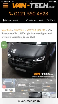

Hi all, I've just faceifted my 6 to 6.1 with aftermarket lights ( see pic) and have few issues, no FRONT sidelights when ignition OFF….. no Dimming of Drls when dipped beam turned on…… and indicators miss a ‘wink’ now and again ….. all other functions work…..is there a loom kit for this or wiring mod….. i cant be the first to do this can i ?
I don’t know about these headlights but on standard headlights there’s no issues or the transporter hq headlights as I’ve had both on my t6 when I facelifted mine .
Thanks, very strange as they are supposed to be direct replacement for 6.1 standard units and apparantly standard units work with T6 van ?
