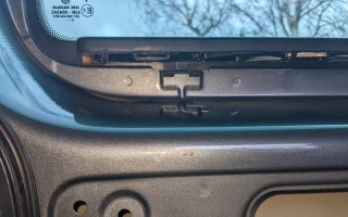

Thanks! I'm not sure I was as clear as I could have been, but I've got a picture now. I'm referring to the plastic 'window ledge' at the bottom which has the grooves for the glass to slide in and leaks to run out of, and the corresponding bit at the top. The actual lip of metal on the inside of the window ... tricky to get at due to the window itself, but it should be possible to tuck carpet into the hairsbreadth gap between metal and glass, where on a aftermarket window you'd have put edging strip. But the chunky bits I'm refering to are normall encase in the big plastic trim in the Caravelle etc. The end of the side are nicely finished, and it looks as though you could have a strip about 4cm deep which clipped to the bottom (top) to give a neat, if not exactly refined finish.
In this side view you can see the tabs where the narrow trim around the window blind would clip: I'm wondering what this looks like in a Kombi sliding window, which I'm *assuming* to be the same part, and imagining that it might have a lower cap that I could get from TPS if I knew a part name or number? Or maybe someone has come up with a sensible alternative way to tidy it up.
From your image it looks like you're missing the lower part of that black plastic rail that the window slides along. My Kombi had a lower part that covered that.
