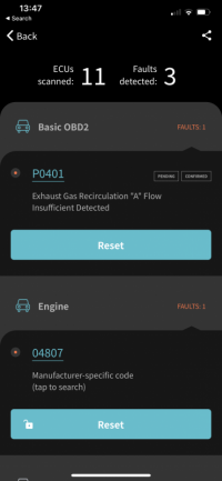

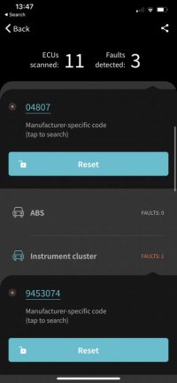

So had the dreaded EML and Carista says P0401
2016 102. Euro5 55k. Pendle map. Always use vpo
Anyone know what 04807 is though?
