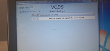

Hi, I've just started using VCDS trying to diagnose a no-start condition on my 2016 Transporter T6. Upon the first launch of the program, I was able to bleed the fuel system one time.
On 2. try now most of the tests Output Test functions not working, all reporting 'Refused by Control Module' 7F 2F 7F .
Need to bleed the car more.

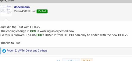

It is a Hex+can <->usb i use.
I see on forum maybe cabel to old.
I can’t help with the specific problem but I use the same cable on a 2017 without issue, so I’m pretty sure it’s not caused by the older cable. They are good to 2018 MY
I think you need completely back out of the controller (close/reopen the connection) between tests. Just click on Done/Close to get to VCDS main menu, and start by reselecting the engine (reopening the connection). On some functions ignition need to be recycled to initialize the controller - especially when configuration changes are made.
Tried that, not working.
