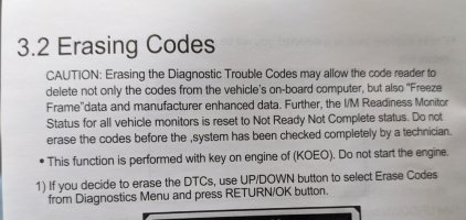

The OBD has the ability to delete the code, delete sounds a bit final and this is what it says in the manual.
Is deleting using this unadvisable? surely it just needs a 'reset' and is there a better OBD that allows this? or should I just wait it out and see if it resets?

You only need the code remaining if you're planning on taking it to get repaired otherwise I'd delete it because if there is another fault (unrelated and potentionally more serious) you wont know it's happened because the engine light is already on.

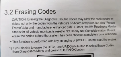

I could possibly reset or erase as it says in the book (see below) I'm just a bit concerned about the other warnings it mentions, not up on this stuff ?
Well, for what it's worth I had exactly the same issue /code ( whilst in France as well). My remarkably similar OBD reader cleared the fault and the light went off - the van did not transmogrify into anything else/burst into flames/stop working and some 1500km later the light has remained off.
