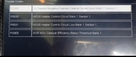

Hi all, I’m at my wits end with codes, I’ve had the bank 1 o2 sensor replaced and have had no luck, these codes are still appearing , any suggestions for help appreciated, thanks in advance 6A8EB0B8-4620-4992-AB9E-30427CE38C11.jpeg
The fault codes actually contain a more descriptive section - copied below:
P2251 >>> Open Circuit​
P0030 >>> Open Circuit​
P0031 >>> Short to Ground (possibly simply no power)​
For now you can ignore P20EE - not likely related.
Wiring problem?
