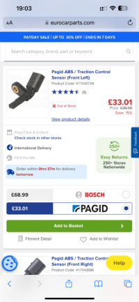

Interesting. That one you have linked doesn’t say if it’s left or right hand sided. Are they universal?

Pretty sure it’s just left or right you’re buying, same fit on front or rear. I remember now why only the Bosch ones were in stock lol more than double the price:eek:
Yeah the Bosch ones are also available. The ones on autos are starting at like 9 quid! Don’t want to be replacing them every 2 weeks though!
So just looked on ECP and they are out of stock so I’ve gone cheap with the bilsteins precise 23824 rear and front left is what it says. 11 quid and in stock on eBay. At that price it’s worth a punt
Some of them included the short wiring loom from the sensor. They were almost double the price. I replaced the sensor only.
