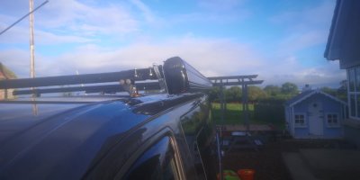

Hi @Stantman I have my F45s fixed to rhino roof bars now. The roof bars needed cut to keep awning close to van due to the fiamma bracket design they also then needed cut. 260 awning fixed at far extents. The instructions for awning and brackets are confusing in terms of where supports should be! The roofbar brackets I got from Fiamma now I understand are discontinued. (PS can not a T6 shhhh but a lwb.)
