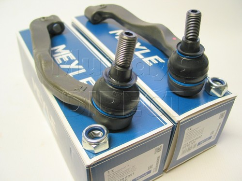

I changed the tie rod ends and lower ball joints for the sake of £80ish while you have it all apart
