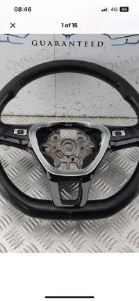

P Paul8976 New Member 10 Oct 2024 #1 Hi does any know if this model steering wheel fits on a VW T6 trendline? 2018 VOLKSWAGEN PASSAT STEERING WHEEL MULTIFUNCTION 5G0419091DF 2016 B8 Cheers
Pauly Senior Member VCDS User Admin Moderator 10 Oct 2024 #2 That looks to be the same airbag fitment as standard T6 airbag so i would say yes it will physically fit but not sure about button compatibility
chappers Member 10 Oct 2024 #3 I have this wheel and button config. on a Trendline and it works fine.
