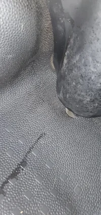

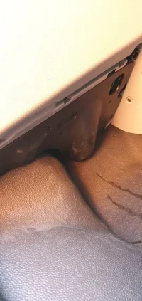

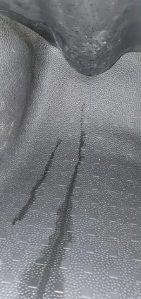

Hi all, I've got a small leak in the passenger footwear of my T6. Does anyone know how I can remedy this? Thanks 20201212_102137.jpg20201212_102146.jpg
Pop bonnet and check if there are leaves etc blocking how water is draining.
In the footwell, behind the carpet/rubber liner you can reach up and feel a rubber grommet (on the a-pillar) that feeds into the engine bay behind the battery. Check if it is seated properly
As above, prob an issue with the aircon condense drain, check the rear bulkhead in the engine bay and you will see a rubber affair that allows AC condensation to drain out
I've cleaned a few leaves off the scuttle panel. Do I need to remove the plastic bit above the rubber carpet to check the rubber grommet? Not exactly sure where to reach to be honest.

If you can get your fingers under the carpet “behind the glovebox” at the a-pillar (door hinge pillar)

I've had the same issue on mine. Its the aircon condensation release pipe that's clogging up. It's happened twice and both times it was a cockroach dead inside.
You have to remove the screws from below the glovebox and above, then remove the glovebox and bottom panel, you'll have direct access to the pipe then. Push out as much air as possible through it then pour some water in it and check that same amount is coming out at the bottom.
Thanks for the replies guys. In the end I realised it wasn't a leak at all. Just some sort of oil or something. Once I cleaned that up, I haven't had anything there since.
