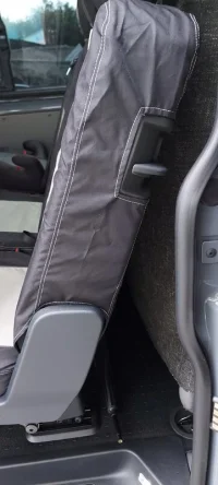

Got a 2+1 set up and the single has a problem. The handle on the side isn't operating the mechanism that allows it to fold forward for rear access. I can see the cable is loose and has a metal clip attached to the bottom of it that I'd say should fit into the mechanism.
Has anyone had the same and how do I reveal the mechanism to reattach it?

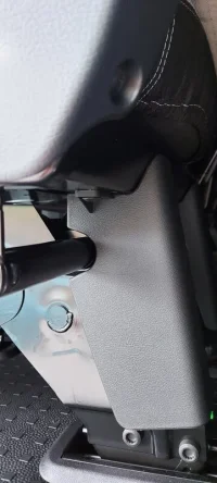

This is the clip that's detached. I took the plastic trim off but it was just a metal plate underneath with no sign of what the clip locates into....any ideas?
Im in at thedealers on the 4th Oct so will let you know. I have taken off the plastic trim but it seems to just cover a metal plate that you still cant see the mechanism??

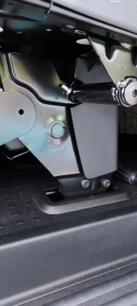

If I could get the seat out, I could probably fix it.
Once you take off the plastic cover, you are faced with a metal plate and you have no access.

The dealer covered mine under warranty. I had three all day trips before I had to leave it and someone dropped it off.
Low and behold, if didn’t work, so I got my toolkit out, loosened all the bolts, realigned it and got it to work.
